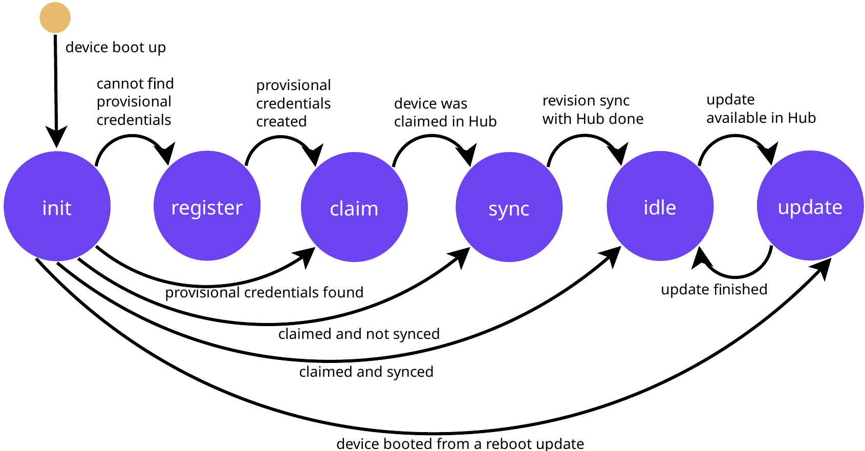

The client state machine goes through the following stages:
!!! Note All states are independent from the Pantavisor state machine, but all their associated processes are run from its WAIT state.
!!! Note The client state can be consulted at any moment via device metadata.
  • init: means we are in remote mode and the client has been initialized.
  • register: device is trying to register as a non-claimed device in the cloud. This credentials will be stored after reboot.
  • claim: device is registered and is waiting to be claimed.
  • sync: device has been claimed and will try to upload the objects and state JSON to the cloud.
  • login: device is using its credentials to start a session with Hub.
  • wait hub: device is waiting for Hub to reply. We also use this to decide whether the device is claimed or not.
  • report: an update finished and device will continue uploading devmeta, downloading usrmeta while reporting its update status.
  • idle: device has checked all objects and state JSON is in the cloud. This is where the device will spend most of its time, uploading devmeta, downloading usrmeta and waiting for new updates.
  • prep download: a new update (same as a new state JSON) has been received and the device will now download the object metadata information for each of its objects. This includes object size, sha and download URL.
  • download: all object metadata is now on memory and we can proceed dowloading all objects that are not already installed in disk. Then we will continue with progressing to the new revision.
