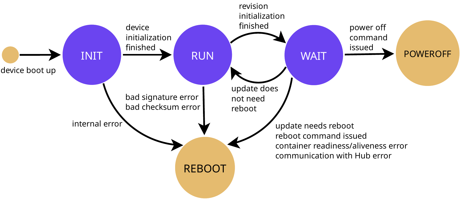

State Machine​
To get a very simplified view on how Pantavisor works, you can take a look at its state machine:
Each state can be summarized as:
