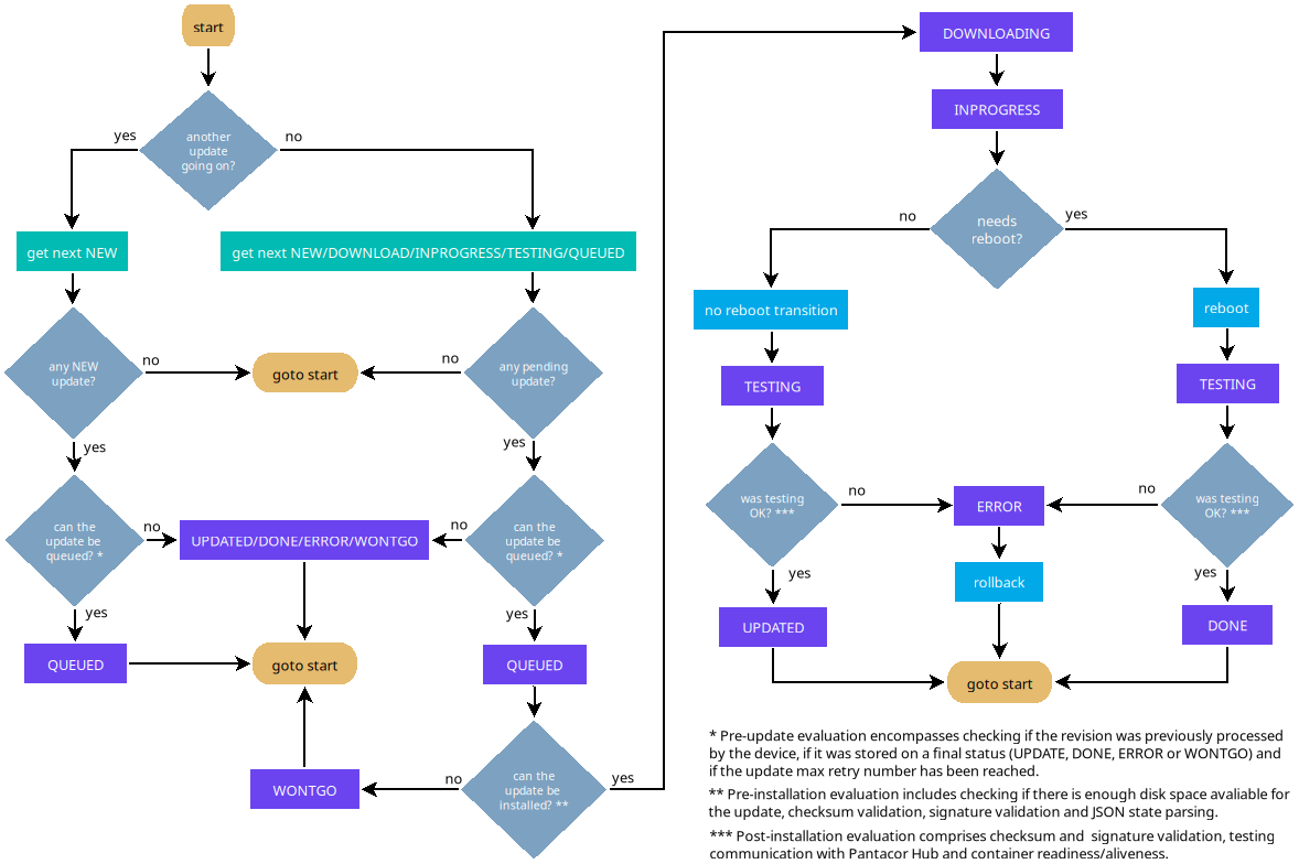

Remote​
The diagram shows a high level concept of how remote updates work. In this case, we have a periodic routine that checks for pending updates upstream and executes the installation and transition to them one by one:

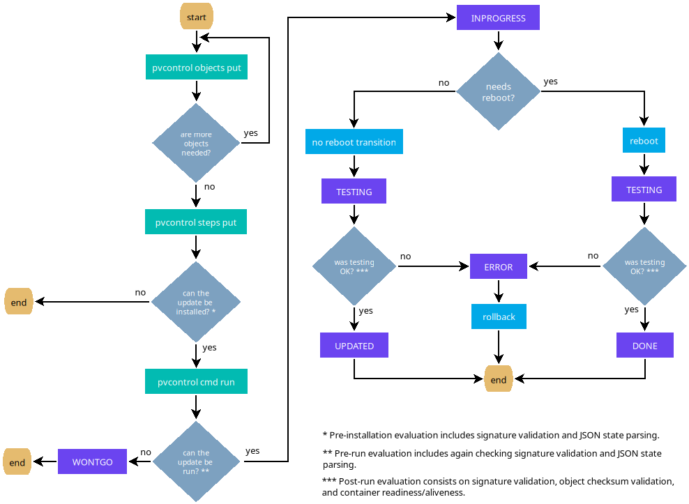

Local​
In this diagram, you can see how local updates work. In the case of this kind of update, we have a one-shot process triggered by a run revision command:
